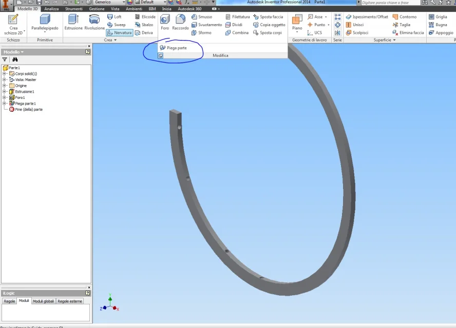

if to bend the profile you use fold part , and you do not create already hundred, you can suppress the processing (piegaparte) and use a visual representation.
I didn't try but conceptually it should work.

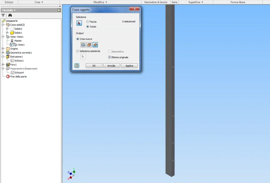

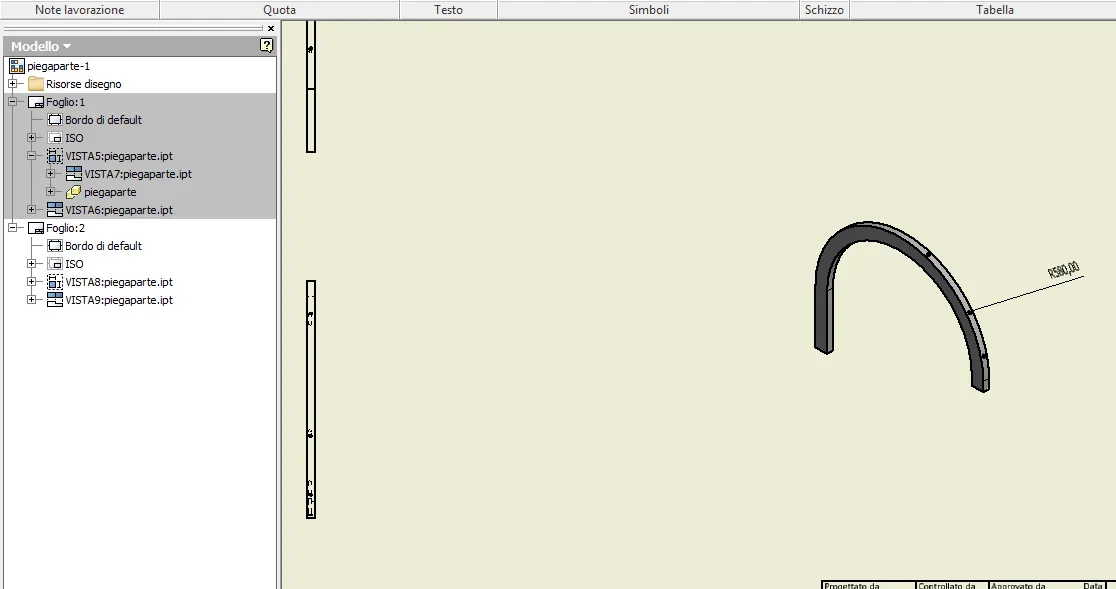

You're right, but I found this little trick.
I copied the solid with object copy cattura1.webpand I created two views in which each one is visible a solid at a timeCattura2.webpAll this, even if it works, it seems to me more like a force, especially because I don't know how it can affect the mass of the part when inserted into an aid, I don't have all this preparation to help you more, I'm sorry.

Hi, I didn't realize you meant a profile and not a sheet.
The method they have already indicated for me is fine.
I normally proceed as follows:
1) I create the part of the profile excluding the fold part and save it
2) I create a second part where the previously created part comes, I use the command folds part and save.
3) in the table I call part 1 to have the explained profile and part 2 to quote the folded profile.
I hope I've been clear.

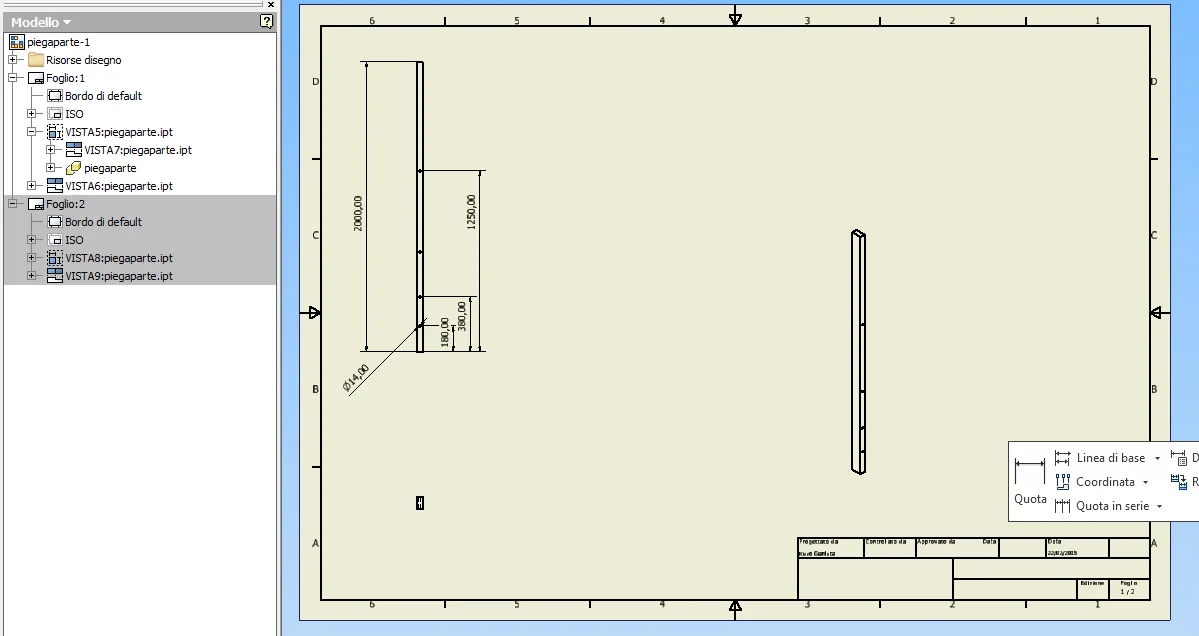

Great. then I solved in the following way and it works well. I create the part so tops must be. I then create an ipart in which I leave a configuration with the feature and one in which we suppress the bending process.
Finally I make the table, when I insert the inventor piece from the "model status" menu, I can choose which configuration to use. In this way with only one piece, which remains in the axieme with all the others, I can make more put on the table with the different stages of processing.
I thank all the speakers for the advice, one piece at a time we have come to head with a clean and functional solution.

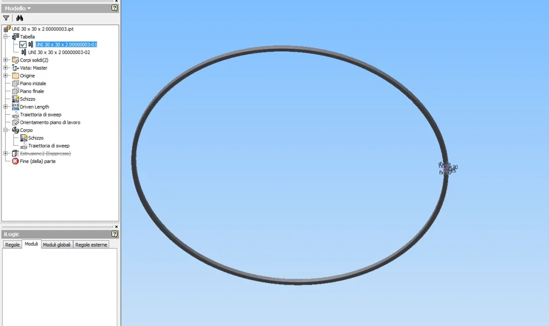

I would like to share a particularity by applying the giannim:
Suppose we create a round sketch and insert a 30x30 profile with the frame generator (as image)
Cattura.webponce you create me enter with open (and not double click) in part 30x30 and we carry out an extrusion of the sketch profile contained in the sweep from the initial floor to the final floor, then applying the gianni metedo we have the frame with ipart both round and straight where can describe the processing.
It's an application that can be very useful if you create frames with curved parts.
If I wasn't clear, let me know.
