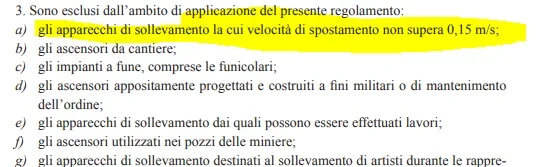

beyond the suggested link in the previous post you can also be useful this document that reports the regulations in force and how to install lifts by derogation when the structure of an existing building does not admit the standard size.
thanks to the answers,@terastore what you have reported unfortunately cannot be applied to my case as it is a platform - 'lift' that does not exceed 0.15 m/s1664203005859.webp
