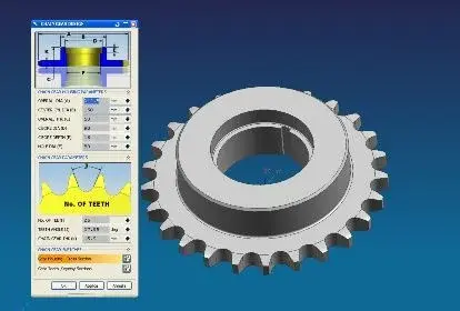

I was studying how to customize the reuse library in version 6 and I came across a chain sprocket.
I refer to the "standard parts/pts/metric/sprocket gear.prt"
Unlike other models contained in libraries where or there is a parameter file in .xls or the parameters are internal to the file as "part family" this model has a completely different editing interface .
Has anyone ever tried or knows how this interface was made?
I attach an image of what I'm talking about

pts = product template study, if googoli also find movies that show you what it does.
p.s. obviously needs a separate license.
