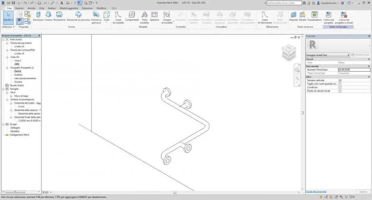

Hello everyone
is my first day of revit, usually using inventor.
for the moment we have followed 4 hours of course, of which much on the concepts regarding the bim in general, and a very small part on how to draw objects in revit and insert the properties, so they are just at level 0.
I designed this handle because I can't load the harp or even zip it?) but while I drew it I didn't insert parameters, I put fixed odds.
Can I still change them, putting a parameter instead of the quota? If so, how?
That's right.

once the permanent quota is inserted, it can be transformed into a parameter at any time.
select the quota - in the interface (rebbon) you will find the “Add parameter” button and from there you can create what you need.
if the parameter is already present, at the quota then assign an existing one. :-)
