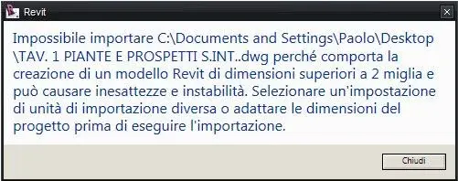

Hello everyone, I am new but I have read you for a long time especially in the autocad sector. I have been using revit for some time, but I have a problem importing dwg from autocad. in particular the error is the one displayed in the photo.
precise that the unit of measurement are meters.
thanks to everyone, I can't understand why

maybe in the autocad file you have layers hidden at 10 light years away? try to zoom extension
Thanks for the answer, I have 63 layers and one was far enough, I eliminated it but that was not the problem unfortunately. .
