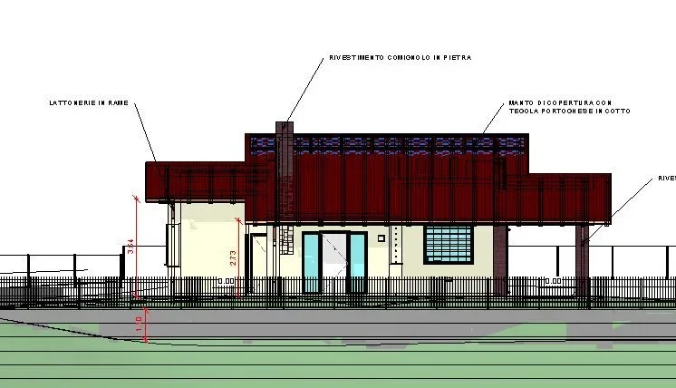

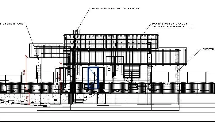

ProspettoCorretto.webpProspettoErrato.webpthe two images represent the correct prospect that I had saved in pdf and that currently displayed in revit

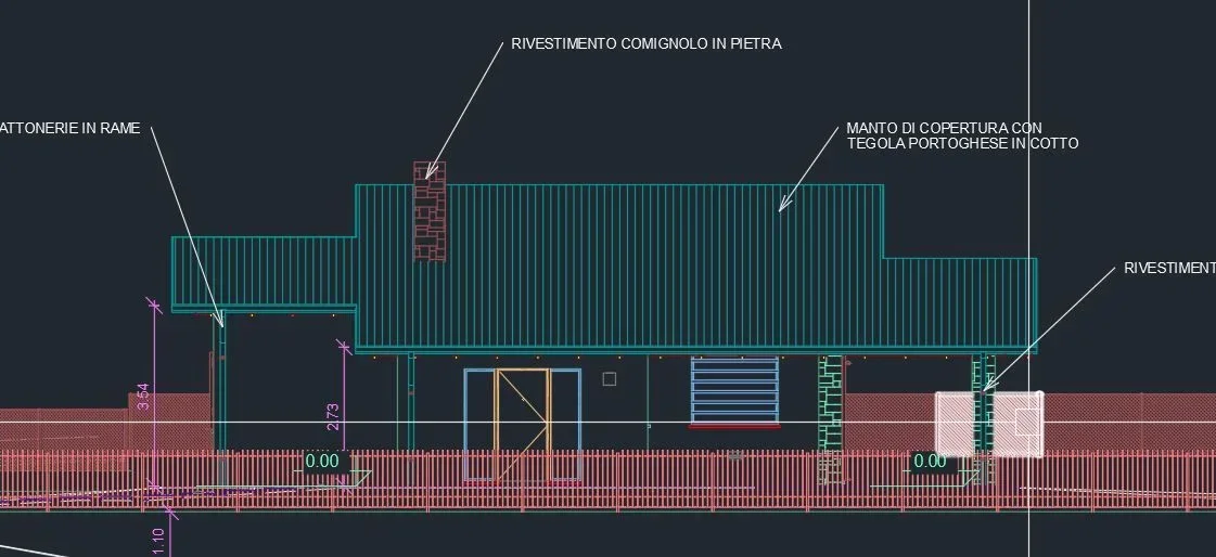

I exported to dwg and the file is correct CadCorretto.webpif instead I try to print it in pdf... the processor goes under effort and after several minutes of processing it still returns the errorPdfErrato.webp
