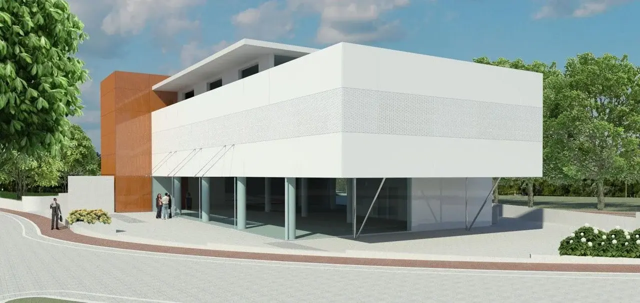

back façade.
the panels I think they go benign like this, some further little change and stop. The lights aren't giving me what I really want. I used 277w countertops and initial color above 6000.
even rectangular lamps are from 100w and with daylight color...maybe I need more powerful.
for the curious I can also post what I used :d
advice?

according to me it will be a little difficult to combine an external light with regular internal lighting also because the external exposure value travels on value 14 while inside on 9
for me you should do 2 render by activating the section pane, 1 only of the facade and 1 cutting the facade and seeing the interior.
overlapping them then the alpha channel will do its work
I thought I would increase the light intensity even of values that in reality that lamp does not support, simply to get a more suitable rendering.
Of course, if in a project I should also present an energy analysis I would need to use lamps or spotlights with their factory features. Maybe in this case I could choose the product and see if ies and rfa are also provided.
That's good, too, you didn't have to be trying to find the right brightness.
