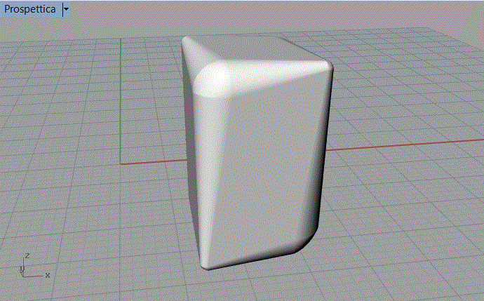

I'm making this parallelepiped and I'd like it to have all the beveled sides. the bevel is on one side smaller and on one side larger.
I can't smooth the two ends of this parallelepiped. I don't understand where I'm wrong. select the "fillet" command and select the edge for the connection, but I do not get a proper bevelling.
Angoli Arrotondati.gifI'm sure I make a mistake of thinking, but I don't understand where...

so doing I get a homogeneous bevel on all sides. I would like the bevel to merge with the bevel of long sides so as to have a narrower bevel on one side and wider on the other.
Esempio.gifHow can I do that?
How can I do that?

you need to study the fillet command....see example of billy73.
Yes, exactly billy73 your example is exactly what I have in mind!
can you explain to me how to proceed x realize it?
I was raised to get the bevel I wanted. My mistake was that I didn't work on all corners at once!
Immagine1.gifImmagine2.gifNow I see that the bevel is not very soft, but we come to create almost a straight line between the bevel and the sides of the parallelepipedo. How come?
How do I make the bevel soft and melt with the sides?
What you're doing is not a bevel but a ray.
calling things with the right name helps you understand.
by force of things you have a visible line, it counts that you pass from a curved surface (the ray) to a plain.
with a single command is geometrically impossible to make it disappear.
you should split flat surface and radius with an isoparametric for example, then between the two edges go to create a tangency surface.
But you lose the regularity of that radius.
depends on what you need.
