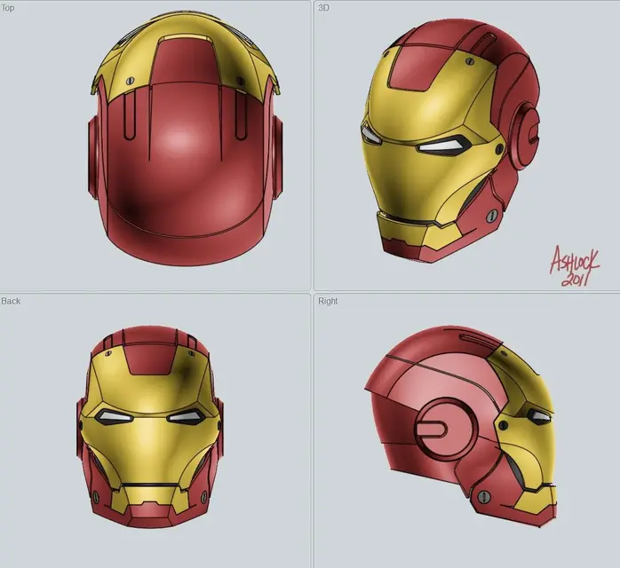

I am looking "dispersedly" to draw the mask of ironman as exercise. .
I have made other drawings a little complicated but this just can't,
the yellow part above the mouth I just can't figure out how to do it.. I tried them all. .
there is not some good soul that would make a video, even only of the front part.. It's not long. I think someone capable in half an hour does everything. .
thanks x the attention
good holidays
x understand us, I am now in this situation and I cannot understand how to make the area delimited in green a surface
the only thing I think I'm sure of is that I can't tear it apart x don't create edges that don't have to be
If someone wanted to open it, just create the surface that is already bound.
