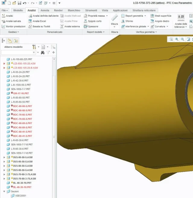

Hello everyone,
I renamed several files with the appropriate command "rename file" but at the opening of the axieme these result with the old provisional and however missing names, where am I wrong?
I thank you as always for the answers and the collaboration provided,
good day and good work at all.
In fact I have seen that to properly rename the files must be opened both the interested part and the assieme or sub together. . So I'd say I fixed it.
thanks dani-3d
