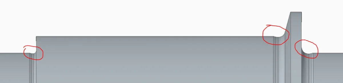

Good morning to all, I ask you if there is a way to "save" one or more feature in a block, so you do not have to repeat the same procedure on different parts of the design. I better explain: I have to perform a whole series of exhaust gorges for grinding on a tree, on different diameters and with different sizes. now as now, or I cover the sketch of the cut of revolution, I change it to the need and the bond in the various positions or directly I remake the sketch where I care and re-execute the feature. Is there a way to save the procedure and call it back? Thank you very much. 1710931165227.webp

Yes, great works. only thing that I can not bind the reference quotas (the black ones) that proposes me automatically, because it makes me choose only vertical profiles of facade and not the diameter lines (I should select the horizontal yellow line that is a diameter).
depends on how you built the feature, you could create a closed profile with odds compared to the edge.
or you can always edit the profile after placing it
