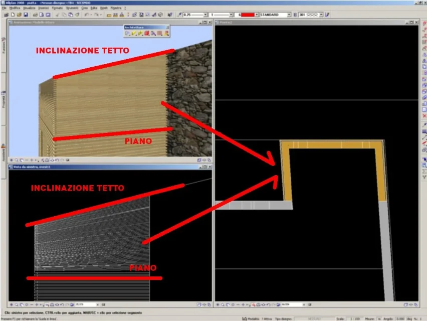

as you can see from the post image I have a problem with an unsolicited interaction of the roof level and the wall profile,
I'll explain better.
I needed some walls of the building I'm designing to be covered with horizontal wooden strips,
quinti I created an ad hoc section then using the wall profile command I created the wall with horizontal strips.
on the ground floor and first everything ok, but as you can see the second the strips follow the tilt of the roof and therefore do not turn out horizontal.
How can I solve the problem?

behavior is correct. architectural elements in the presence of a rule, like the roof level, follow this rule. to ensure that the buffer/wall remains horizontal, binds the upper edge of the wall/closing to the absolute level giving a quota.
if I bind the wall to the absolute level giving a quota as you suggested
to do these things there are several ways in allplan. At this point, however, I suggest you transform the architectural elements into 3d and then cut the protrusions with a cutting plan and then delete the excesses.
