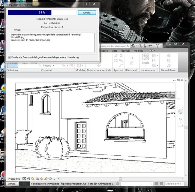

I also attach pictures
in the wooden roof image you see the transparent hidden roof that contains the tiles, in the image rendered as you see it is completely transparent
