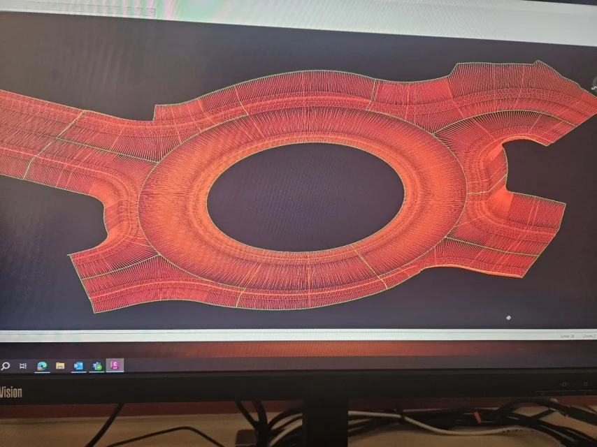

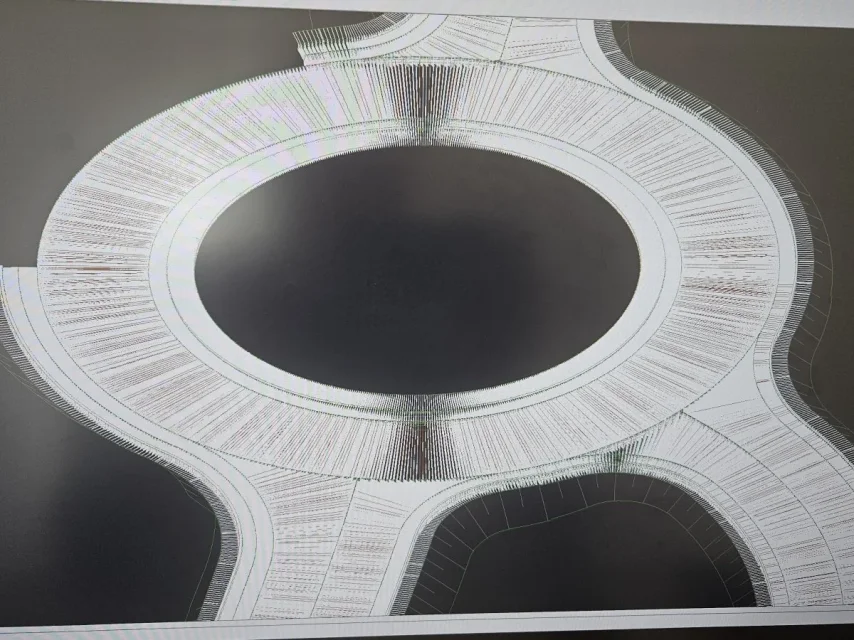

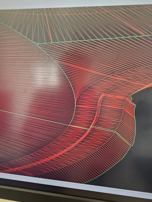

Good morning, everyone. I would have a question to ask you. they are struggling with a design of a roundabout with four arms very close to each other, therefore the wizard to create the roundabout automatically fails to manage this situation. I have created traces of dx and sx for each arm and its tracks connected between the latter and the roundabout (traced with the outer edge of the lane). Unfortunately I realized that the connected tracks do not follow the elevation of the proncipal track, so the result of the three modelers does not work, as I do not have continuity of transversal slope, but steps. I wanted to know if there is another way to solve such a situation. I attach photos. thanks to all

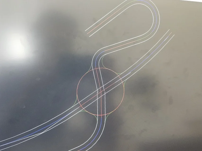

it would be better if you also attach screenshots of the sections where you see these steps and planimetry with well highlighted traces.
I attach some photos for a more complete analysis

I do not see the views section and/or the type sections used. How's the string type section made?
