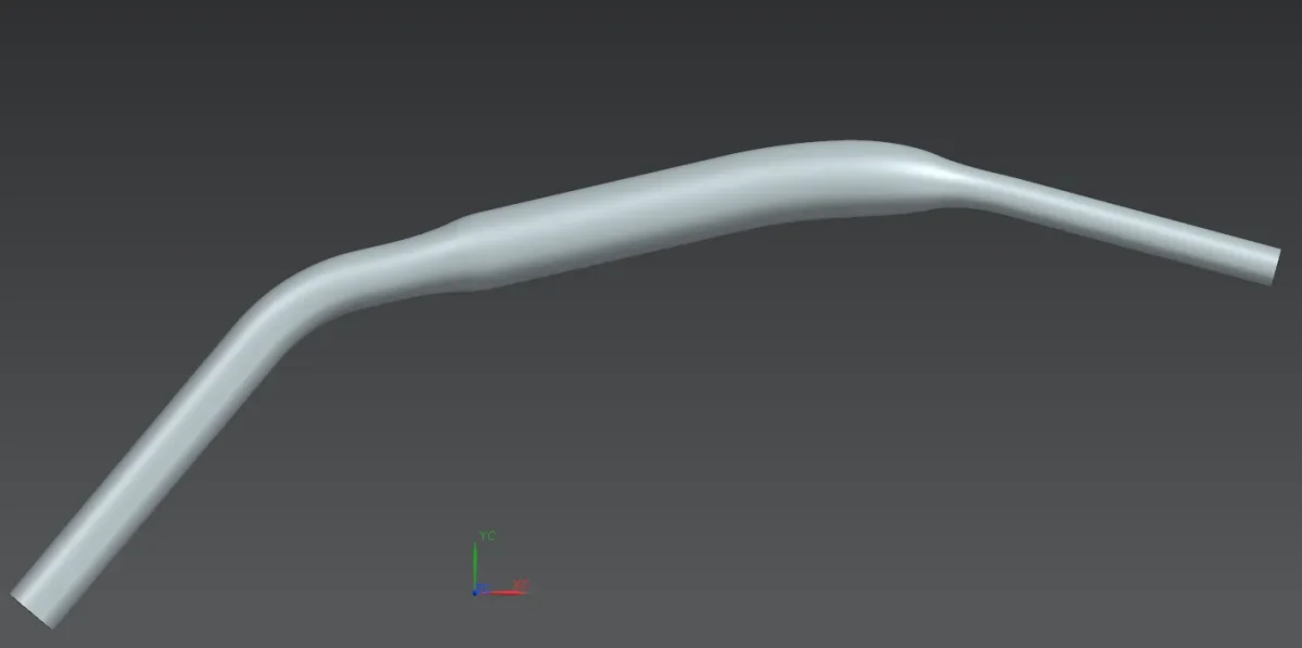

I exhume this post because it is always relevant, if you do not think so divide as well.
in creating a pipe with the path you can create rake and widening without making other features like revolutions or similar but keep everything in the feature tube?
No, much more banal.
I don't want to compare "from rulers" with solid edge is in the tube command where you can work the ends. I wanted to see if it was possible with nx.
so you have to make an additional feature at the end?
the standard "tube" modeling feature only makes the tube (spine + external diameter + inner diameter).
that sophistication you have to add it (I think it's not a great job: 2 excisions, or split the face + offset)
