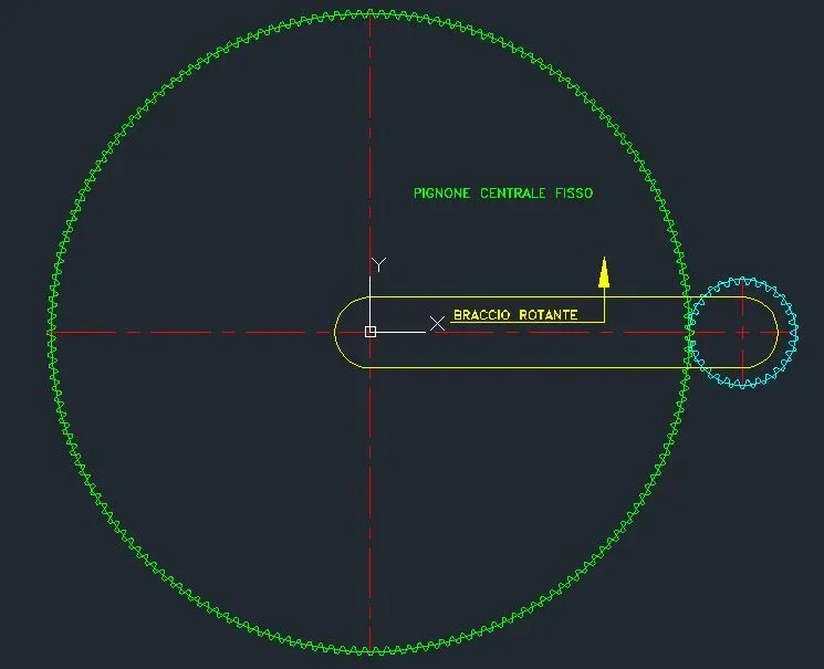

Hello everyone
I'm asking for help, I'm learning inventor.
I would like to create the movement of two gears as in figure,
the central pinion 180 teeth remains fixed,
the satellite arm must rotate along with the satellite that has 30 teeth.
Someone could give me directions.

hello and thanks for your interest
use inventor professional 2015.
you in the movement curtain are the commands of the movement, but how do you use it?
here it is not only the two gears, but there is also the arm or
the satellite gear rotates on the central gear that stands still with ratio 180/30 = 6:1
for a complete round around the central gear turns 6 turns
the arm must follow the pinion,
I can't even create the exact movement between the two gears.
it would take a mini tutorial
The first solution I think is
pinion z180 blocked
pinion axis constraint of coincidence with axle xxx arm
Axis Gear Coinciding Bond With Arm Yiy Hole
a rotation movement bond between gear and arm hole xxx with rotations of the case
