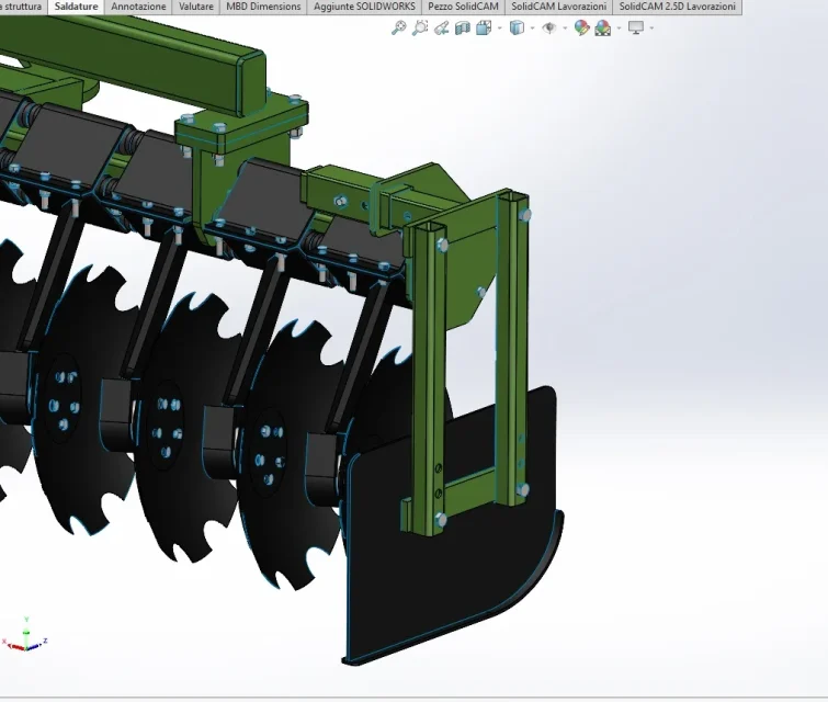

Good morning, here's a photo of a detail.
practically when I go to save the axieme as part, saving only external faces, the software loses some faces and marks the edges with blue lines.
As already mentioned, the blue edges are due to your current color setting of solidworks, blue by default are the edges delimiting the surfaces, they are all surfaces without constraints between each other.
if you change color setting you can show you the color you prefer
exactly, the color is not real. is the cad setting that shows it like that. I wouldn't worry. You do a little test and give it to those who have to do the job.
if you pass in shaded display (without borders) you should no longer see them. in solids there are black edges, in blue surfaces.
