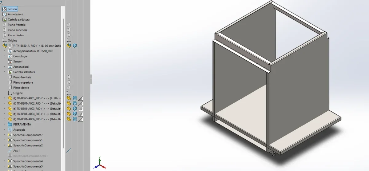

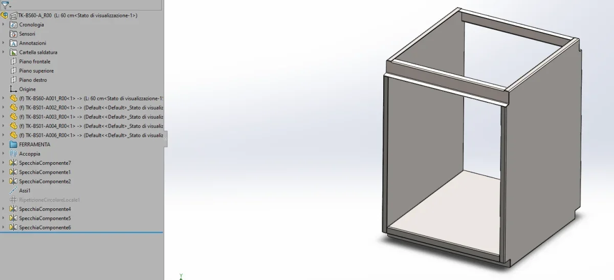

I am designing an outdoor kitchen and I began to approach the configuration with the data table to create configurations based on the width I need.
schematically:
- I went to create what is the starting base that influences the various changes in width (img 01)
- I went to create the total of the base in a first set (img 02). based on the various configurations that I need I went to create all possible cases and, in this case, it seems to work practically everything (img 03)
- the problem comes now when I go to insert the welded axieme into a definitive set where it seems that the configurations no longer work (they are connected practically to the first welded assembly) creating this problem (img o4)
I have wrong design approach or there is a special rescue because if I go to save the file with configuration 90 cm if I open that from 60 I refer to configuration from 90 cm....
I hope I've explained well. Basically I would need every base to stay in the correct configuration for when I make the various configurations (I would need to save the modules 60 - 80 - 90 without that repercussions all between the various assemblies).
thanks and who can help me
