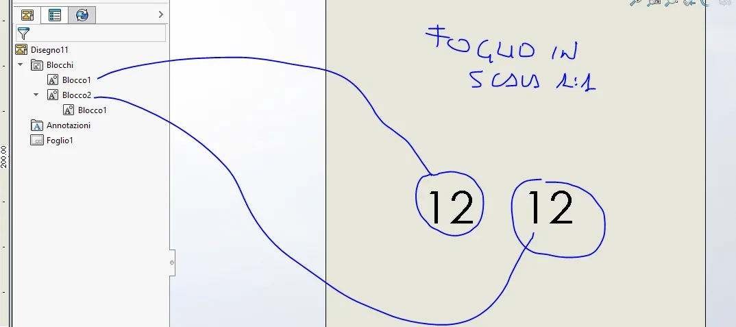

Hello everyone
someone can explain to me why it's what1642503605286.webpsheet size scale 1:1
1:1 scale blocks
2 blocks as from image
the second block contains the first
when I pass the sheet format in scale 1:21642503728563.webpthe second block containing the first increases its size
instead the other remains equal (that cmq is the same content in the second)
Obviously if I explode the block of 1libello. ..that below goes back correct with the unscaled text....I tried to upload on the internet but nothing tells me that solid does not manage the "nidified" blocks or better the texts in the nested blocks
I'd try to explode the second block, that's the one in the main block.
However I did a test and to me changes the scale also of the nested block, usually does not change the scales if the block is imported from an autocad file, if it is an autocad block tries to explode and recreate it.
Spark.. .they are blocks created in solid....for now I don't use nested blocks I don't use them anymore...because I can't understand why you call the text...when I don't tell him and do it

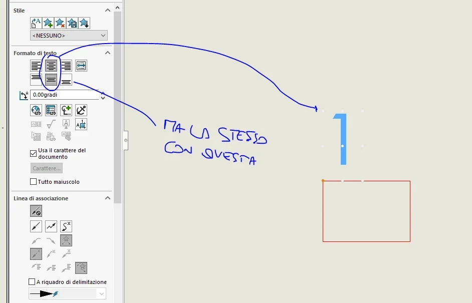

continue here with another problem of the blocks
as from image below1642947402823.webpIf I block with text with formatting as from image, when I go to explode and everything ok, I find the text in the same position where I placed it
if instead as from image below1642947550631.webpchange formatting
when I explode the block1642947612484.webpas you see the text does not remain in the original position
it only comes back after I made a ctrl-q
otherwise remains in the posizone that solid calculates at the time of the explosion
But........why does that?
Has anyone ever noticed?
possible solutions?
I tried for sculptor with various versions of solids from 2017 to 2020 and nothing changes
