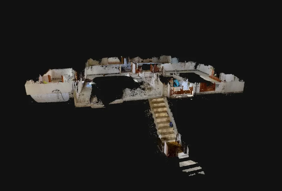

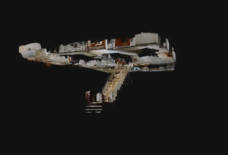

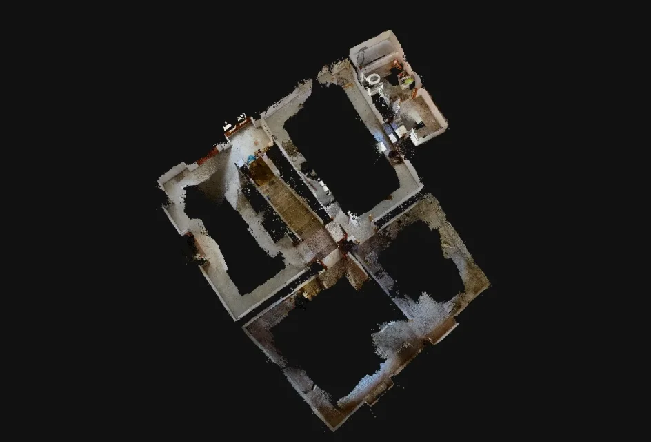

some time ago I read about rollingport, but I never deepened the topic
This is a 3d virtual tour made with a rollingport.
It's a mix of photogrammetry and laser, which is, I think every photo taken contains information from laser. I think the machine used is a rollingport.
But for the reliefs it is necessary to have measures. I don't know how long this technique serves for a classic relief, where a 3d environment can be reconstructed with real measurements.
