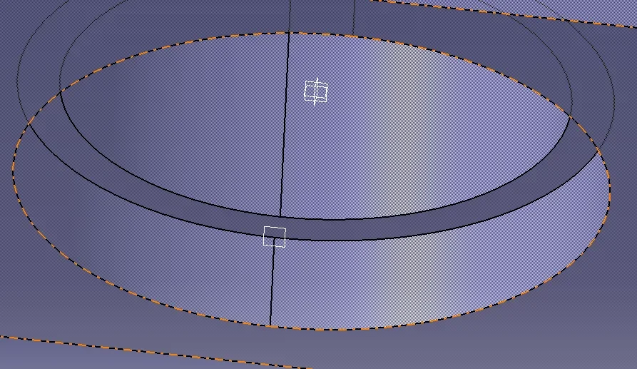

Bye, guys. I used the search function in the forum but I found nothing to do with my case. are struggling with creating a banal seat for a hole stop ring, but I just can't. I have little experience with catia and at the course they taught us to do only external seats (e.g. piston bands) with tongue command starting from a sketch. Now I find myself in trouble, because I can't create a sketch on curved surface when around I have material, I don't know if I explain. how do you in general create your homes? I attach image that maybe you can clarify a bit. the problem can be reduced to the case of a parallelepiped with a hole in the center, within which to develop the quarry. thank you for the help and apologize for the perhaps trivial question. Cattura.webp
in another body draws the quarry as it was a full (a record to make it simple) and then do a subtraction with the command remove
just the yoke board, although I think missing the method to get the normal plan to the curved surface, the problem remains for you and for other models. . .
krissbetar, you must try to use the reference elements (view/barre of the instruments/reference elements) there, find the basic commands such as lines and plane points, which are used to generate the simple geometries that lead to the creation of plans to be used for sketches.
as you can see, the command plans, has countless options, just because to work you have to start from these reference elements.
in your case first put a point on the edge (point on curve), then create the plan (normal plane at a curve) careful to select the point first then the curve.
in the sketch using the option cut the part according to the sketch plane, you can orientate to insert the section of the quarry.
Once released, use the tab command.

you just need to do a proper sketch on any floor passing through the hole axis, in fact the plan that makes you draw gianni passes through the hole axis.
If you don't have those plans and don't want to create them, you can squirt on the face where the hole ends: make a concentric circle to the hole and take off from appropriate distance to another.
