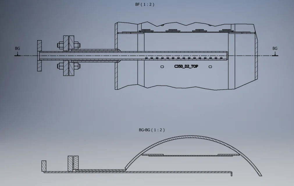

ina cos a little strange, but it is possible from the bf section at the top creating the bg section complete it
And not half?
try to see if, by clicking on the view in the panel "design view - display options", all spuns in "cut inheritance" are unchecked
probably does not do it because in the design view is selected the "base" view style and first you have to uncheck that, otherwise the section view takes the style of the base view.
And here is how you say:
1724701428355.webpBut I don't know how to clear the spuns.
Maybe I have to go to the main view?
And not half?
with the bf section you "slapped" your set for which a half is non-existent.
if from this try to dissect further with bg it is obvious that you will not see the inside but only the half remained.
I disagree to make sections of views in the section just to not stumble into visualization and understanding problems
no, re-made the section of the same object, and then the section and I was corrected.
I saw that the cut inheritance, the 4 spuns were unchecked.
