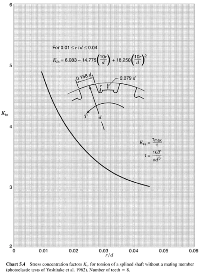

for the values of carving coefficients look well on the net that you find something. possibly look on the peterson’s stress concentration factors that is the book where there are the curves that serve you.

If you have a groove you can use this chart for twisting.
However they are indicative curves and not exact, otherwise you should do on the single piece under review.

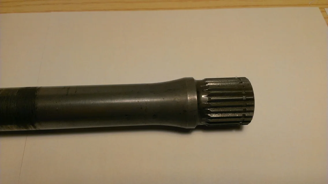

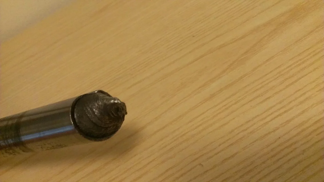

the break seems like a fragile break with fatigue, it seems more a break due to too much torque as you say! But I don't understand if the broken part is that differential side or that wheel hub side.
I attach some pictures
I don't think it's been long since the fracture trigger where there's a milerighe where it crashed into a break in the smooth cylindrical part.
the twist is seen from the lines on the tip cone that are helical.
the fact that it is very accentuated means that the load was very high.
probably also had a flexional component that blew sideways of the tree pieces.
looking at the photos could be broken on the joint side wheel.
However it could give that there was also the connection radius like the other end, try to see if there is...because if there is no need to break there.

there is a connection that connects the millerighe (external diameter greater) to the rest of the semi-axis but without the shouldering that instead is present in the integral part. .
I thought that probably the break occurred at the time of landing from a jump (maybe on some asperity that acted as a flender load) without the pilot taking off the foot from the accelerator.. is it plausible?
as a maximum torque you can use the maximum transmissible from the tread on asphalt in dynamic conditions, as an agent load on the wheel take that of the suspension completely packaged, friction coefficient between rubber and aphalt and tread diameter.
This at least should ensure that the tread begins to slip before the semi-axis ceases.
On the other hand, take the maximum torque resulting from the maximum torque that can be transmitted from the clutch in the shortest torque available.
this should ensure that the clutch slips before the semiasses ceases.
When you are reasonably sure that or clutch or tread slip before the break of the semi-axis you can reason on exceptional events, for example when the car lands from a jump on a single wheel with the release engine, in this case the differential tends to slow down the wheel again in the air, which obviously when it touches the ground is in a very bad situation, in this case the speed of the differential and the engine is not possible
- Slip the tires
- slip clutch
- the car changes speed instantly
- the semi-axis shatters.
If the pilot keeps on track and the powertrai group maintains a speed more or less consistent with that of the ground there are no problems, problems arise when it lands with very different speeds.
Another typical case is when traveling with very blocked differentials, in this case the two wheels are "litigare" between them and the semi-assisted make their expenses

One more thing. It is not clear to me how you could break up at that point.. i.e. if I had seen the whole semi-axis, I would have thought that we could break up on the shoulder connection radius (where there is the short millerighe).
semiasse quotato.webpInstead it broke at the beginning of the conical zone (as from drawing), where I think it is less present the carving effect. .
the semi-axis combines a differential with a wheel, for it there are no inclinations (which are managed by the homokinetic joints)
Maybe the breakage started out from a mileage fault
