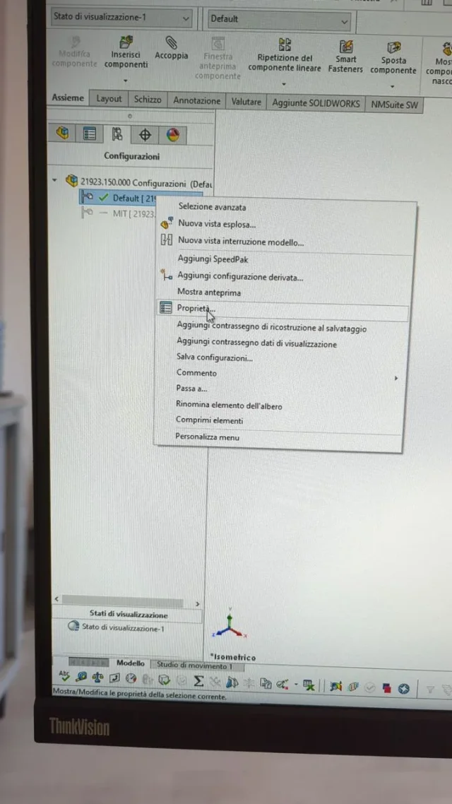

hi you have to right click on the configuration---> choose propertiesphoto_2_2024-01-25_09-22-12.webpopens a menu and choose "promote"
photo_1_2024-01-25_09-22-12.webpIn that way, in a separate set, you will not appear below together but the individual details that you can post at will.
Thus, any fictitious subaxis made only for assembly convenience do not result in the distinct.
