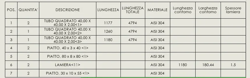

Good morning, everyone, I need to take a question.
I have to insert a separate cut of a multibody part consisting of tubular, folded sheets and processed pieces.
is there a possibility of having in the same table the voices of the length of the tubular and the development of the sheet and its thickness? Do I have to create a column for every voice? 'Cause I'd get a little bit of a size chart. . .
allego screen how I created the table at the moment.
thanks in aniticipo.

you can add as many properties and columns as you want.
the size depends on how much information you want to insert and how you manage, so the size depends exclusively on you
Thank you for the answer I understand. In my case, what I would need is a table containing information like the one I attach. to avoid having such a large table can you group for example sheet information (lungh, largh and sp.) under a single column?
