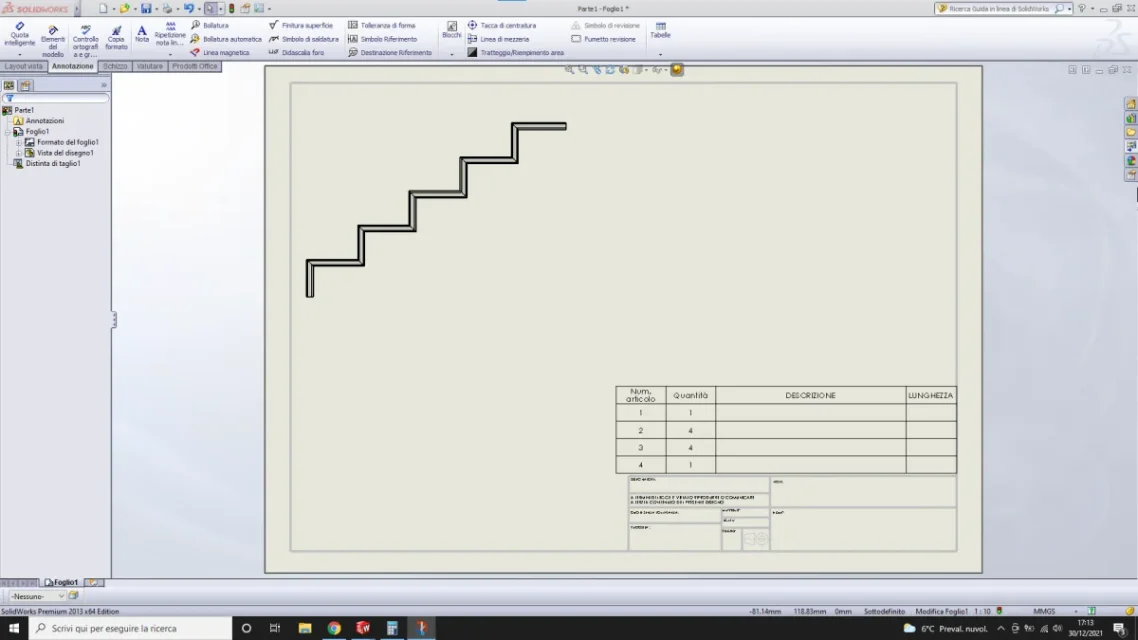

I have a problem., in the harvests the separate cut recognizes the pieces tells me the quantities but does not put the length and description of the various pieces, why do you think?
ok attached table and piece photos

in the feature manager at the top there is the separate cut, expand and right-click/property on each folder, inside you find the item description (if there is no crri) and fill it. the length must already be present.

in ambinete part correctly compile the properties with how much you care to have in the cutting distinction
in the drawing environment in the cutting (not that material) select a column and in the property manager that appears to you select the custom property item and from the curtain select the item corresponding to the column

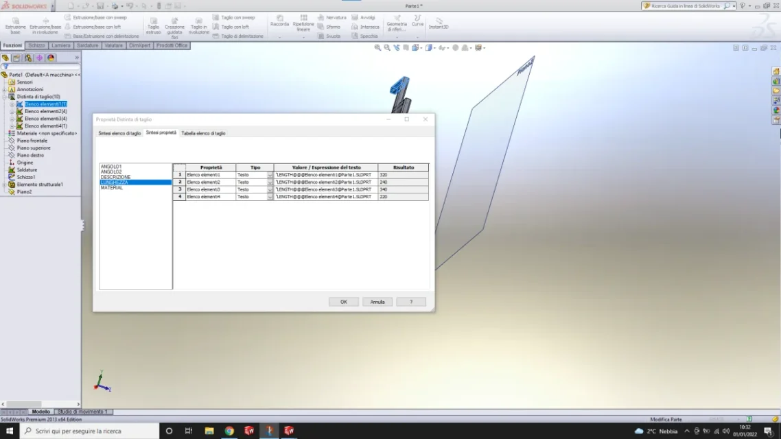

ok I tried now the table is sorted but do not fill the length at the table

exact but in the properties of the part the result of the length is because I don't come to the table instead?
attached demonstration photo
the result is correct but at the table in the separate does not come out
