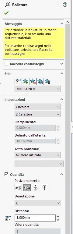

in the bubble there is the option to insert the quantities also as bubble properties you can insert the amount
but it is also possible to do it with separate table materials
a bubble is made only with the presence of a distinct material.

you can do through the bubble.
the only way I found to connect the tables is as follows:
insert the bubbles on the part by connecting them to the various headings no., description, quantity
insert a blank general table
double-click a cell and then select the bubble.
hide or not bubbles.
