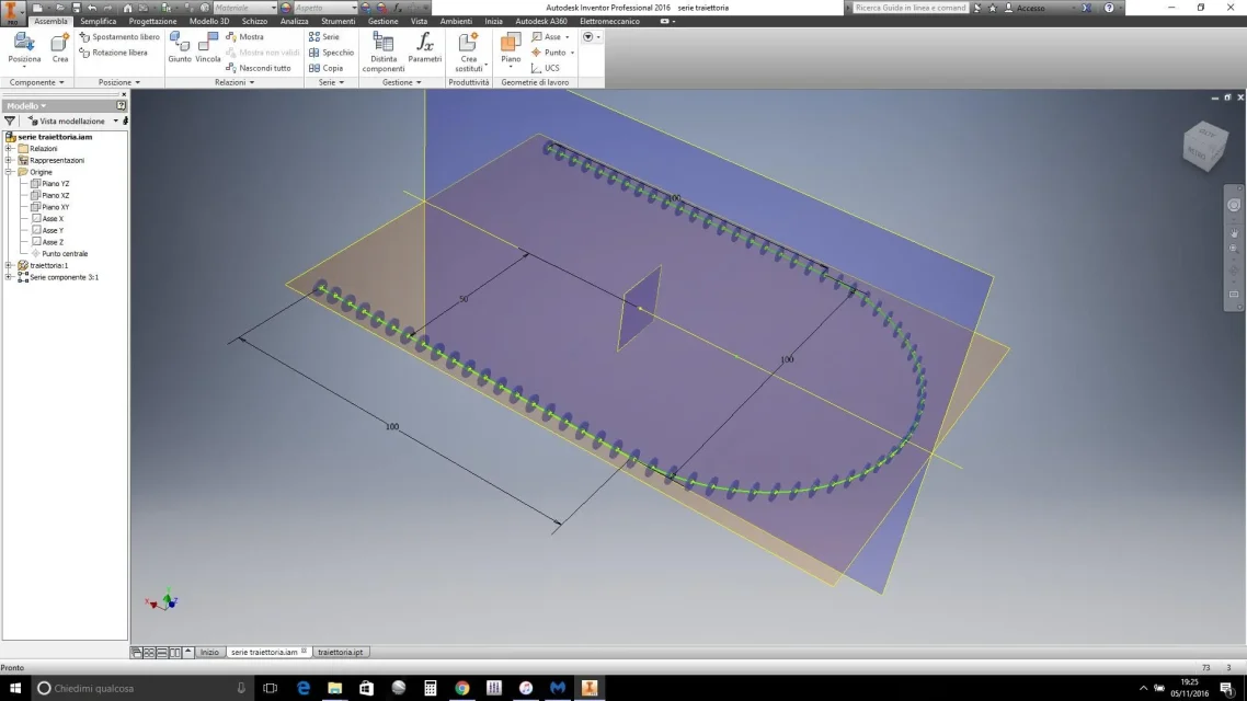

Good evening to all,
after ravaging long and wide in the forum, I can't solve this problem.
in this case, I can't serialize a circular object along a predetermined trajectory in the environment together; or better, I can but does not keep the tangency when the trajectory begins to bend.
I tried to tangent the central axis of the piece to the trajectory, but as you can see from the attached photo, when the curve begins, the piece follows it but without remaining tangent to the trajectory.
Does anyone have any advice?
Thank you all in advance

Below I list what the user "peppe" had written about serializing correctly but I never managed to understand the part I marked:
"I'd create a part that will be your path, on the path you create a point in the base sketch, go out from sketch and create a point on the newly created point (choose word play) such will be the reference to bind us the first part to serialize. of this point you make a series (not in sketch mode but in part) in the series selections curve length and select your path, open the menu and you find direction 1, clikki and select your starting point just created and leave in "equal", then in direction 2 you have to choose direction1 not equal, this allows you to rotate according to the tangency of the path your parts to serialize.create a set, insert the path and the first part to serialize, bind the part on the path and important the half-work of the part (eg the mesh of a chain) the constraints to the point of the path you created before, after you make a series and go to select the series in the part with "select series machining". I wrote a bit quickly, do some evidence then see... .
hope to have been clear selections curve length and select your path, open the menu and you will find direction 1, clikki and select your starting point just created and leave in "equal", then in direction 2 you have to choose direction1 not equal, this allows you to rotate according to the tangence of the path your parts to serialize"

I don't really know how to thank you for the video, you solved me a good problem and now I can serialize in the environment together keeping the tangence to the trajectory; sure...I am a nice jerk not having looked good in the cascading menu of the serialization...he he; this does not take away that you deserve a thousand applause, especially for availability.
Thank you very much
