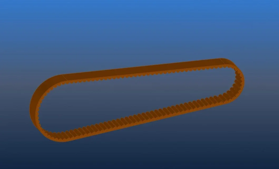

Hello, is it possible to make the belt teeth series following any path? like this... with modeling 19

I honestly think you can do it on a "free" path but you have to give all points and around there is a macro to make a pattern on a helical spiral (spring shape).
on any path I don't seem to remember that you can do, in the end, even if it is not the maximum you should do the 4 four patterns, two for the straight longiline parts and two for the curves.
By the way, if in your case the sides of the tooth are aligned to the sides of the belt, you should make the patterns of space between two teeth as a pocket, instead of the patterns of the teeth.
I did the single teeth pattern in fact... Why should I do the empty "space" pattern between my teeth? I don't understand. Is it easier to do you say?
you managed to make the pattern of the hubs because the external faces of the tooth are not aligned to the external faces of the belt, otherwise he would not have been able to reconstruct all the faces of the other teeth, but I think it is simpler showing an image
your case is like that of the belt first belt at the top where due to a slight tapering of the external faces of the teeth they are not aligned to the red face of the belt, so the pattern manages to close the whole surface.
if you were like in the second case when the external faces of the teeth being aligned with the external face of the belt constitute a single face (the blue one) and making the pattern the software leaves the teeth open and fails to reconstruct the solid, in the image it is seen in fact that it does not make the green face in the preview of the teeth of the pattern but leaves it open.
in the latter case you should have done the dual pattern that is that of the pocket between two adjacent hubs, in this case the pattern working for removal of material, always manages to complete the operation as you see in the preview.
