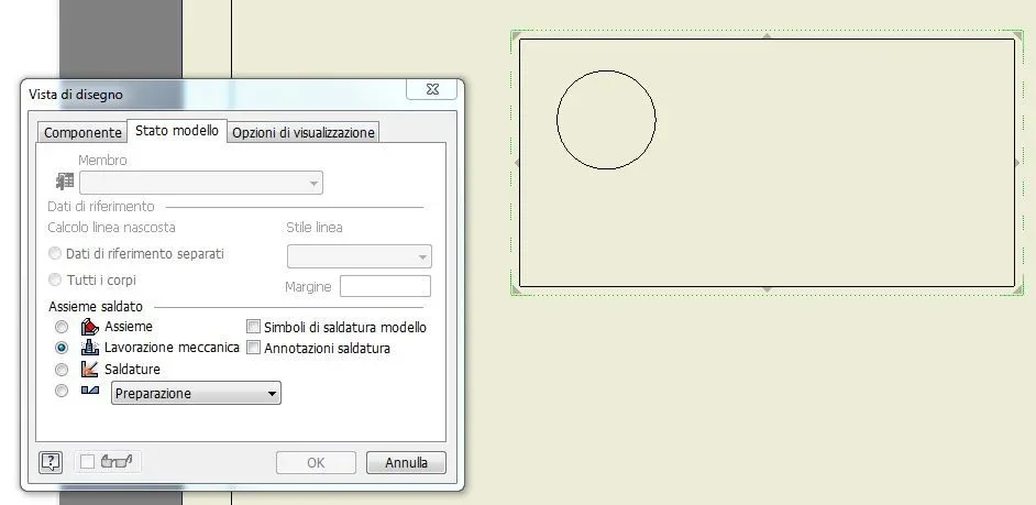

I have a problem about how to represent in a table the processing can carry out on a part.
1_ I have to drill holes on a plate to insert swallows and weld them.
2_ salsa and spy.
3_ perform new holes.
I thought I'd bump into membership views, but on the suppressed work of the part, it doesn't make me do it.
How could I do without resulting another solid, but using the views?
Maybe I explained badly.
Can I freeze a part's view?
for example a view of part 1 perforated and then another view always part 1 with the perforated ?
you can use welded assemblies (I think I understand a set of a piece, but it doesn't make a difference): using the combinations available in the "model status" tab you can practically highlight the parts without working together, with preparation processes, final processing (and welding but now we do not care)Cattura.webp
I prefer to make a set for each stage is more manageable and more stable in case there are many parts
I had tried to use visual representations etc. but if I remember correctly you can't separate mechanical processing from one stage to another
I hope I've been clear
