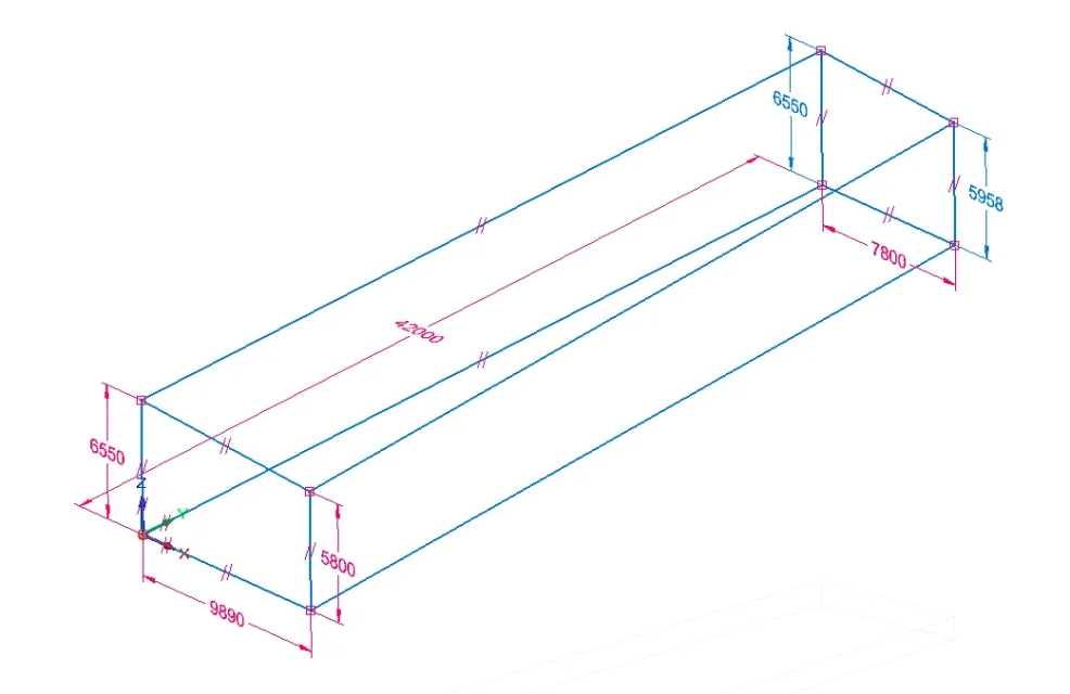

I have to create frames that fit a volume I created with a 3d sketch (I took this road but I can face the problem as I want.
in practice I have to create a 42 meters long cover with arches that repeat every 2 meters (so 21 steps)
for now I have to create the skeleton even in one piece in part environment, for the construction of the individual components I will think about it later.
How would you deal with the problem? I liked the idea of the series because if they had to change my step it would be enough to change that value to have everything updated but I don't know if that's possible.
I also sketched a single arch but then I bowed.

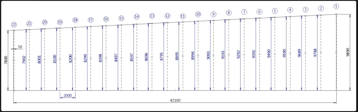

hello francesco and thank you for your interest.
Unfortunately the question is more complex (at least for me).
I have to sample a structure that advances tightens more and more.
the image below represents the view in the plant.
delivery with a 9890 wide structure and finishing with a 7800
for now more would like to know if you may vary the width but in reality I should also vary the height.1708616272970.webp
for now more would like to know if you may vary the width but in reality I should also vary the height.View attachment 70503
the various traverses will be created with a protrusion "to the next"; then impose the sampling on "smart" and the protrusion will be recalculated for every occurrence.
