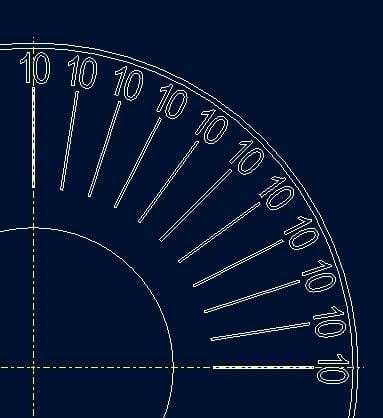

hello to all, I would need to make a set of a sketch with editable sketch.
I better explain, the classic example is the clock numbers, where for convenience I would make a series of 12 items and then edit the various sketches with the necessary value.

hello in the case above you have a constant step, I should be able to put numbers that do not follow an apparent rule or even written.
I don't know if it can help you, anyway you should put the values by hand.
you can make the series and then the selections and with cancellations you find to have all the sketches/operations separate .
At that point, you only put your hand to change the values as you say that you don't follow a logic.
Of course you lose the series

I tried a simple set of sketches on axis but I can't find any variants.

I have wf4, and select the series on the model tree, second mouse button, cancels variants.
