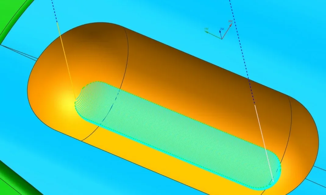

good morning, as from title I would like to reverse the direction of the fresata (now goes from left to right). I tried to change the parameters of "cutting direction" or "cut angle" but do not reverse the direction. thanks alessandro

what kind of processing is it? I'm not a Cammist, but maybe I can ask a colleague. also what version of nx use?
@ alexfunk Hey, I finally got to ask the partner.
He tells me it's enough to reverse the carrier.. .
in nx when choosing a direction there is always the possibility to reverse the vector (yellow-black arrow in the image)
Hello, thank you for your concern. If I reverse the direction of the carrier I reverse the start of the zig-zag but not the direction of the processing that always remains from left to right. I'll try to hear the assistance. thanks alessandro
