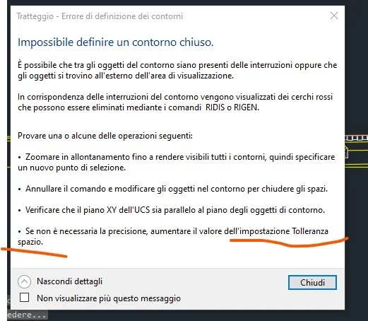

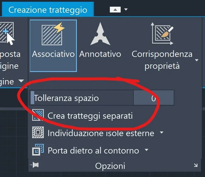

Alex97 Guest Feb 8, 2023 #1 if when I am carrying out a restraint comes out this notice, where I find the variable setting tolerance space to avoid interrupting the restraint, even if I checked all the closures between the lines? Thank you. Attachments Tolleranza spazio.webp 35 KB · Views: 6

Tristan Guest Feb 9, 2023 #4 not necessarily. depends on the design. try with small values then, if it does not work, go on growing
