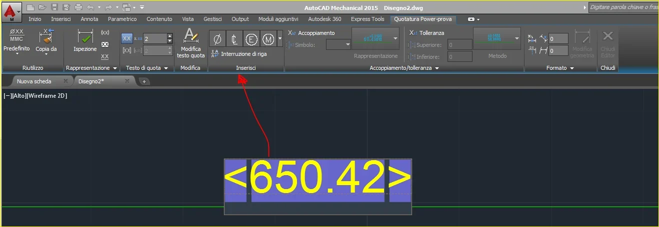

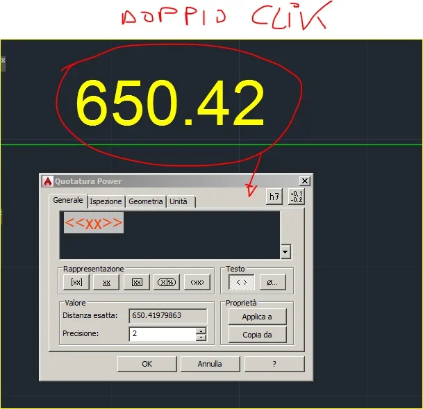

a question...using the classic interface of autocad editing quotas with double click mause... I opened a comfortable and well-made window of which I place the image... now instead using the interface with ribbons always editing quotas with double click I open the same thing but in ribbon format much more uncomfortable and in some things dispersive than the precendeva
I ask you one thing...not and possible to keep the ribbons but at the double click edition will make the tabellina of the classic version appear? ? ?

default powerdim editor:
from the 2010 version (proven on 2016)
ampowerdimeditor = 1 set the ribbon as a power-quote editor.ampowerdimeditor = 0 re-set as editor that "classic of mechanical
