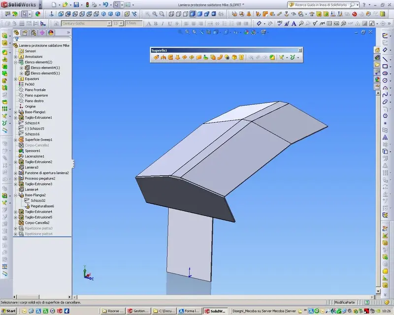

in flange edge just activate "accorcia folds lateral" and he stretches.
I also moved the piego in the outside even if it has no influence and closed some games between the lembi.
You know my deformation.
It works great! !
thanks ciarly, very helpful your advice! !
