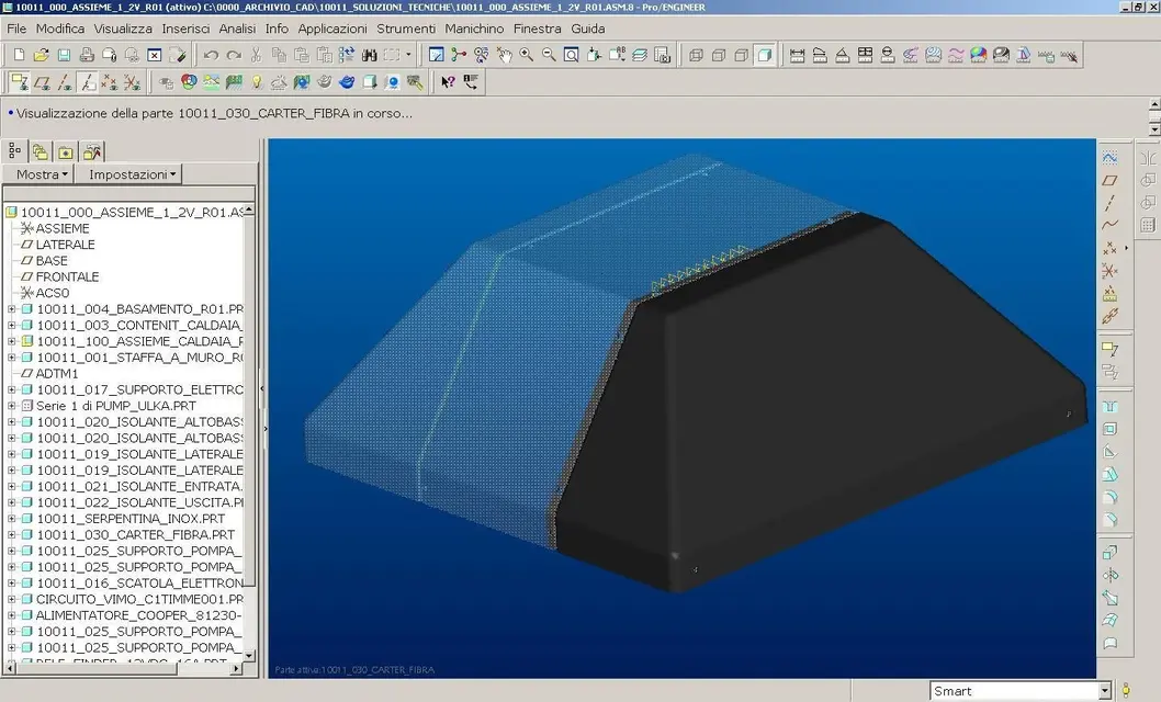

for those who want not to attenuate all the components when you activate one to work on it, just set the variable (from the wf4 onward) "dim_inactive_components" on never in the config.pro

thanks to all, in fact my "problem" is solveable with the selection of everything and deselction then hide, I just have to do the habit, for the simplified representations....beh for now I know that there are and little more give me time.
