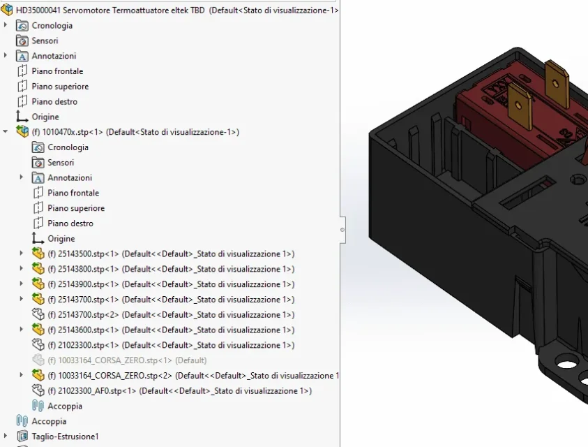

it happens that sometimes amount file step of vendors that however have complex files and I would like to simplify, leaving only the external parts. as you can delete the parts that I don't want. everything is to lighten files. Thank you.
What do I want? I wonder why when I used inventor, whether it was multi-circums that together gave me the chance to cancel. Now I opened an old file created by my colleague, which contains a multibody step, but I can't erase any body.

if the opening of the step returns you a set you have certain possibilities, if you return a multibody you have others, if you return a part with a unique body (e.g. a motor) the possibilities are reduced, but there are.
said so does not help to understand. you have to imagine why you can't erase a body and it's not easy.
a multibody has, in the feature manager, a folder with the list of bodies; you can also create a separate cut if you want to have a little more control. in any case with the delete body function you can maintain or eliminate the desired bodies.

You can't do anything because you opened the step with active 3dinterconnect.
open the step by turning it off and you can mess up the files as much as you want.
