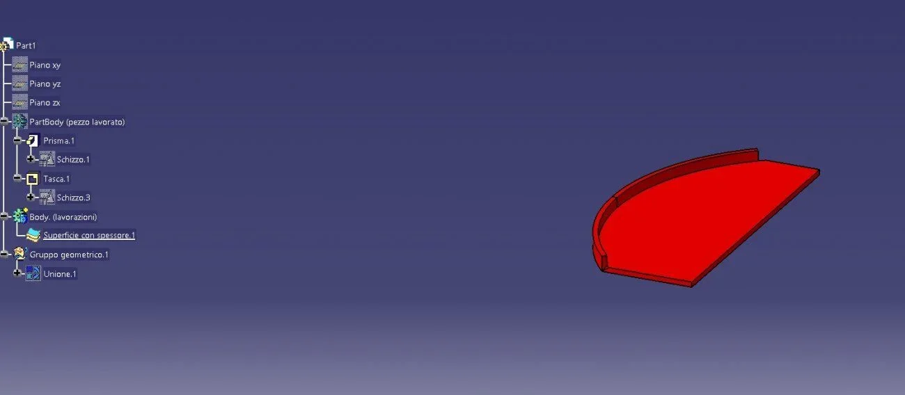

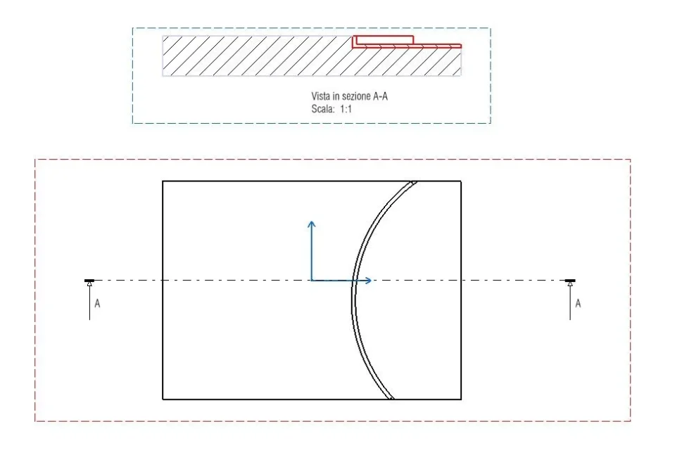

I usually go backwards.
I create the catpart of the complete piece of work and in the same catpart, I add a body with overmetals of processing.
Having separated the body, I can also manage the setting of the particular by showing, in the various sections or views, the supermetals of different colour.
Let me know.
I attach an example

Hello victorious,
I haven't thought of your idea sincerely. Could be a solution. Of course it is a slender thread but could solve the question
Hello victorious,
Yes, it is a bit artisanal, but avoided to create two models: the worked and the finished. for my personal use is good
if then the milling department needs the crude.. I'll do a boolean operation, and I'll put the supermetals on the job.
Let me know.
