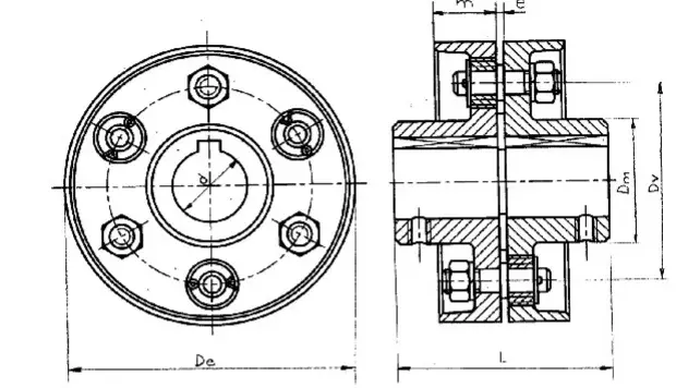

in the specific case of the pole joint I would say that the important thing is the following:

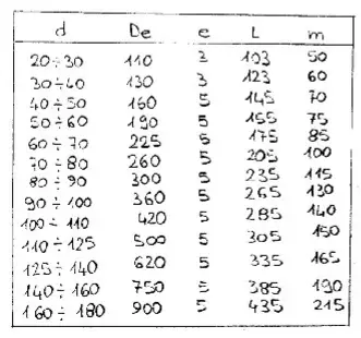

I'm sorry.the principle of operation of the pole joint is to resist cutting after the rotation torque has been transferred on the individual pioli.giuntopioli1.webpon the market there are more or less standard dimensions or however recommended that they are summarized for example in this tablegiuntopioli2.webpthe actual calculation, once calculated the torque to be transmitted, that is:
