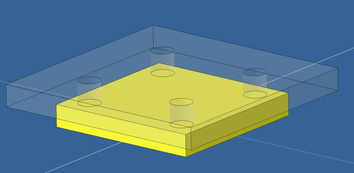

I'll explain better and get a picture1640081497650.pngto "copy" the drilling from the transparent part to the yellow part you must:
work in total, double click on the yellow part
1640081890507.png so you move into childbirth.
do a sketch on the yellow part, in this you can use the command project geometry, for example by copying the drilling. then extrusion.1640082174682.pngI hope I've been helpful.
