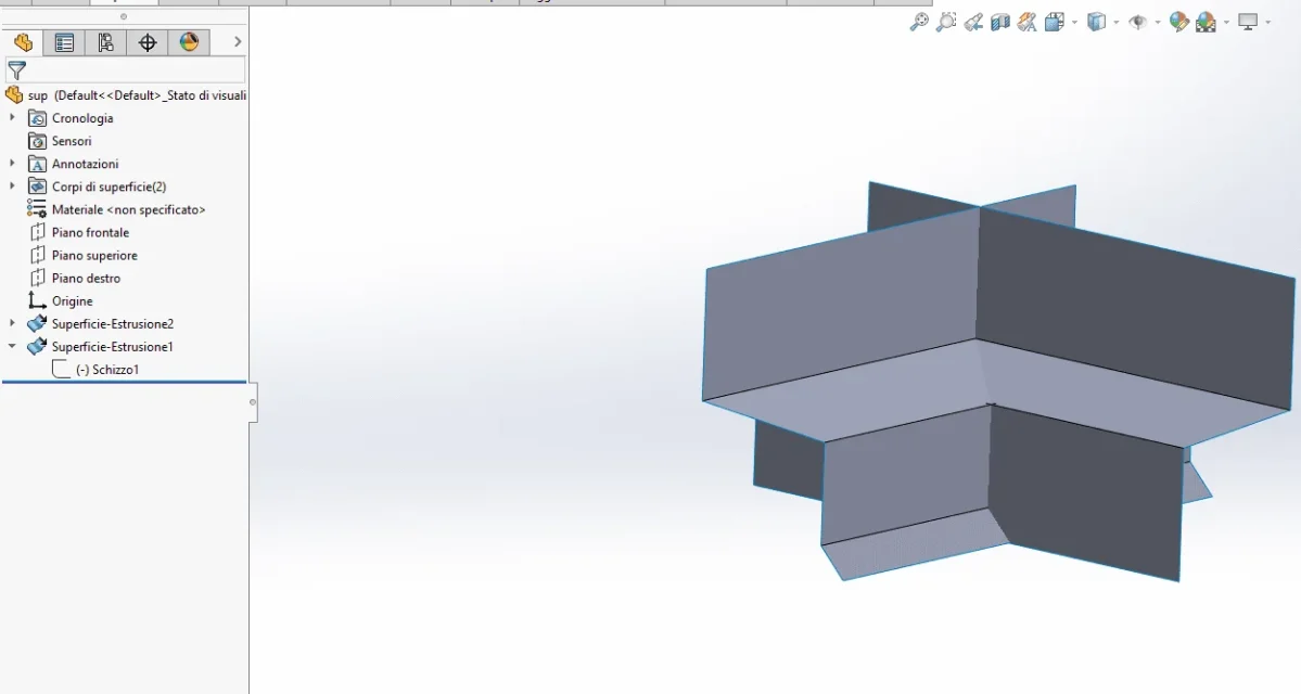

hi to everyone... I often happen that when I reorder the workings in the function shaft, actually the sketch from which the workmanship depends still remains in the old position and it is understood by deleting the function
I move 2 images and an example file
1623344755836.webpas you see, I moved surface1 after surface 2
but if I go to clear to the surface function11623344846812.webpas you can see from the image the sketch returns before surface2
Can someone tell me why and how to solve it? ? ?
After several tests it seems to me to be a situation that only does with the functions of surfaces.
summing up:
with the functions of surfaces the sketches, after deleting the function of belonging, are ordered by progressive number of creation.
with solid functions the sketches, after canceling the membership function, are not ordered by progressive number, but by allocation order in the feature manager.
the functions are sorted by sequence of realization (example: if in the tree you have in order sketch1 and sketch2 making first the function of sketch2 and then sketch1 you will have in order the function of sketch2 and then sketch 1)
I also noticed that it only does it with the surfaces...so it is solid that manages it in this way
