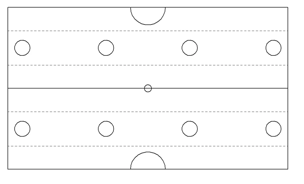

do you know whether in any way it is possible to screw a 2d skizzo in model 2d environment or in view ?
I don't talk about adapt or scale but just of a stretch, in order to understand the circles should become oval strecciando on x1713947068115.webp
_ a command like this in 2d does not exist; You could:
- copy the sketch and use it in one part to create a protrusion
- use the uneven scale command to deform it as desired
- put the part on the table
- disconnect from 3d to get 2d geometry again
trafila longtta, also works only on non-sheet parts, sin there is no uneven scale in the 2d
you wrote that you have a 2d sketch not a sheet; If you already have a sheet you can use the command switches to part to use the scale command in an uneven manner.
