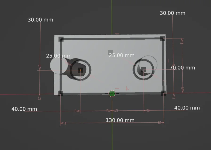

slide guide
  • Thread starter Thread starter kyochera
thank you very much for all the suggestions!
wear is not a problem... there will be only a few daily scoring
In this regard I was wondering if it was not possible to use a compact 24mm bearing and thicken it with a 0.5mm sheet to get a "reduction bushing" from 1mm (25 to 24).
I ask you to specify all the parameters and variables of this project because each post is added new information and reasoning more or less precautionary and/or stringent must be reworked.
Moreover, given your crazy crazy idea of interposing a sheet between body and bearing, I also ask you, despite being advised in the regulation, to present and give us information about your mechanical skills, so as to calibrate questions.
I have no training in the mechanical sector.
is not a commercial or professional project is only for hobbies use and with little wear. the most important information I do not know which are for professionals of the sector: for this they came out only during the discussion.
from what you have advised me I think the cleanest solution is the reduction bushing turned by a professional. or a real bushing made to measure.
in the next few days I will go to ask for some quotes.
bhe.. After all this information, including little precision, with reduced movement, poor wear, dedicated to hobbyism and considered that you have no equipment to intervene with. . .
I would return a boccola ø25 outside and ø16 inside nylon
