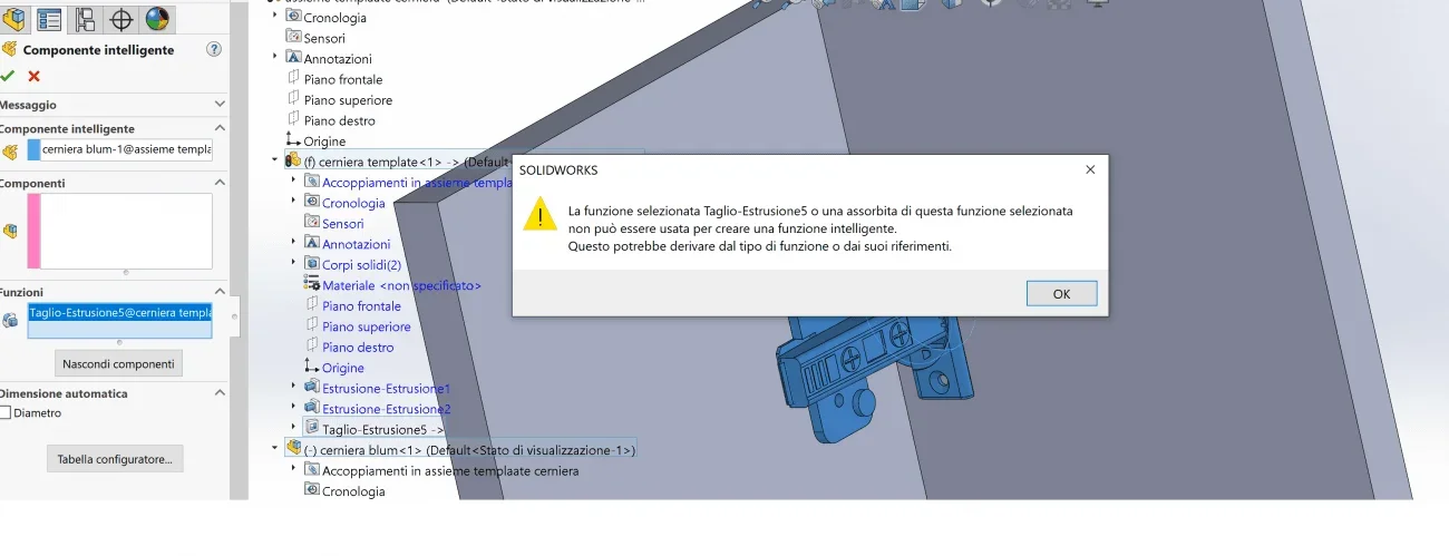

and what changes from what I did? it is always about moving the component from one position to another.
so it also works to me the problem that the hinge is bound to the structure of the furniture and to the door, changing the size of the furniture for example the height the hole is not moved accordingly
in this description you don't understand much. also because of the lack of punctuation!
You say it works for you, too. I mean how? I did nothing but move the smart component.
why the fact that it is bound (how?) to a structure and a door should affect the operation?
a reason could be if it is a subassieme and this would compromise reconstruction as it has already occurred in other cases. So I wonder, what's the condition in which you find yourself when you say that it works to you too?
However when I say that the hinge is bound, I mean that the zipper coupling was made both on the structure and on the door.
If I create an axieme on one side (the mobile) and insert as a smart component the zipper (which is a set of two parts) by mating it for example to the furniture door, once the smart component is activated if I move the zipper manually along the door, the holes follow the zipper as in your video.
the problem that once fixed the hinge to the furniture in all directions, if I change the size of the furniture (modify the part by intervening on the global variable) the holes of the hinge do not "follow".
I try to add a video so you understand better
what does that video use if you only see the static hinge, but do not move it manually and above all through the modification of the furniture? what you have attached is the equivalent of an image.
Once the smart component is activated if I move the zipper manually along the door, the holes follow the zipper as in your video.
in the meantime this establishes that it is not a problem of subaxis that behaves correctly
that there is a management through global variables comes out only now and it was not possible to imagine it with the information in possession.
make a clear video in which you see the shift of the hinge either manually or even better, attach the simplified axieme so as to do some tests
