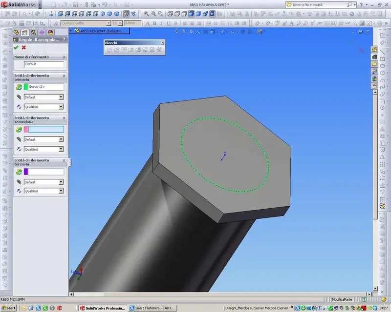

Today I was wondering if it was possible to use this function with self-tapping rivets that I am drawing for my personal library. . .
Also tell me if and what did I wrong in putting the mating rules? I want the stem to be concentric and the bottom of it to be tangent to the face below?
go to the toolbox... in pem-metric, and check if that model is present.
If it's not there, open a similar one and look at that coupling.
If you want to keep yours, splash a circle on the head of the component and use it
to make an extruded cut of a few thousandths.
then add the mating rule by selecting only the edge of the cut.
leaves everything default.
save the component and try to insert it into a set.
ps, forget about smart fasteners.. .

Thanks mike for the answer, now I go home and try... in my toolbox of swx 2010 there is no "pem" of any kind! I just wanted to try to see if it was automatically mounted in place that I want with just one click, but from what I see and from my little experience I think it is. I'll let you know. :finger:

I did exactly as you suggested and everything works great as I imagined this afternoon... That was exactly what I was trying to do! the trick of the tab key did not know and I must say that it is very convenient!
Thanks again for the quick help!
I'm taking advantage of it if I can... !
I tried to do the same the hexagonal threaded rivet but I couldn't find an element so fast for the drag&drop as before... .
If you have time, take a look at me?
Thanks again.

I hope I've guessed how they fit.
However in the sense to create a coupling is that.
Unfortunately the rivet with hexagonal section of 6.4mm must be mounted in a hexagonal hole of identical dimensions. Actually the rivet is 6.2mm and the hexagonal hole of 6.4mm. I also tried with the faces, with the edges and the section but I couldn't. or better I managed but I have to give in a second moment other mating relationships and not as previously with the round rivet of today afternoon!
Yeah, that's right, that's stupid. I didn't notice.
tomorrow I try again, now after 11 hours we swx I have full balodes.. :biggrin:
