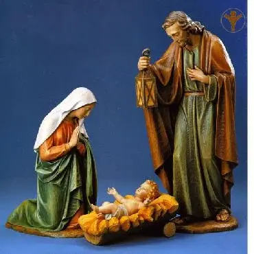

I would need advice to understand which software to use for a new job.
I have to draw the figurines in the crib, to be printed in injection.
I would therefore need a program for the modeling of people, so as to have ready the proportions of the body, on which I will design the clothes.
At least I thought of doing this modeling path.
What do you recommend?
Here is an example

But the statuettes are the ones in the picture? Do you have any copies? no because at this point you make a 3d scan of the same. there is a free sw of autodesk called 123d catch that works with photos. look that it is very complicated to make organic modeling of characters with dedicated sw, it takes a lot of experience.
try to take a look at make uman, open source sw that has bookcases ready of characters that you can edit, otherwise it is hard to do everything from head, especially when the character is something very precise, as in this case, and anyway with all the sw 3d you can do, like 3d studio, maya, ec. blender is the open one.

I would advise you to let alone the idea of putting yourself in 3d of human figures that are not saying beautiful, but just just decent.
imho is a sperch of time and energy and since it requires the qualities of visual perception of the shapes of a sculptor, it is worth learning to make the true and not virtual sculptor. I'm not kidding.
make the statues that interest you, dress and fit, by a good one then make it a high definition laser scan.
I'm sure you spend infinitely less, you do first, you don't mind, and quality is just a little less than that of the real object.

I am aware that drawing human forms is really difficult and that is why I asked for a dedicated software that would allow me to have the body in the meantime.
The statuettes I should draw are many, some of which are very small. molds are now ruined and you cannot produce decent samples for 3d scans.
precisely because they are over 20 figurines and therefore a beautiful amount of work, I would at least do a test to see what comes out but without the starting mannequin I don't even look at the sample.
