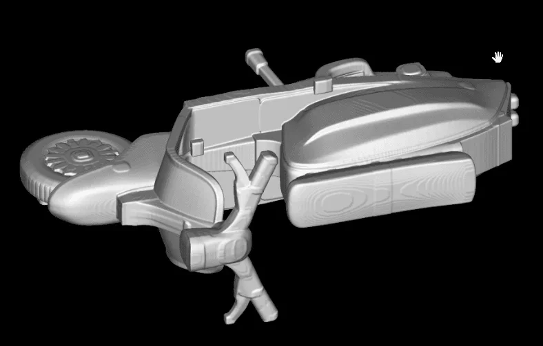

hi, I made some experience to correct stl models with holes and thin walls to be able to print them in 3d
