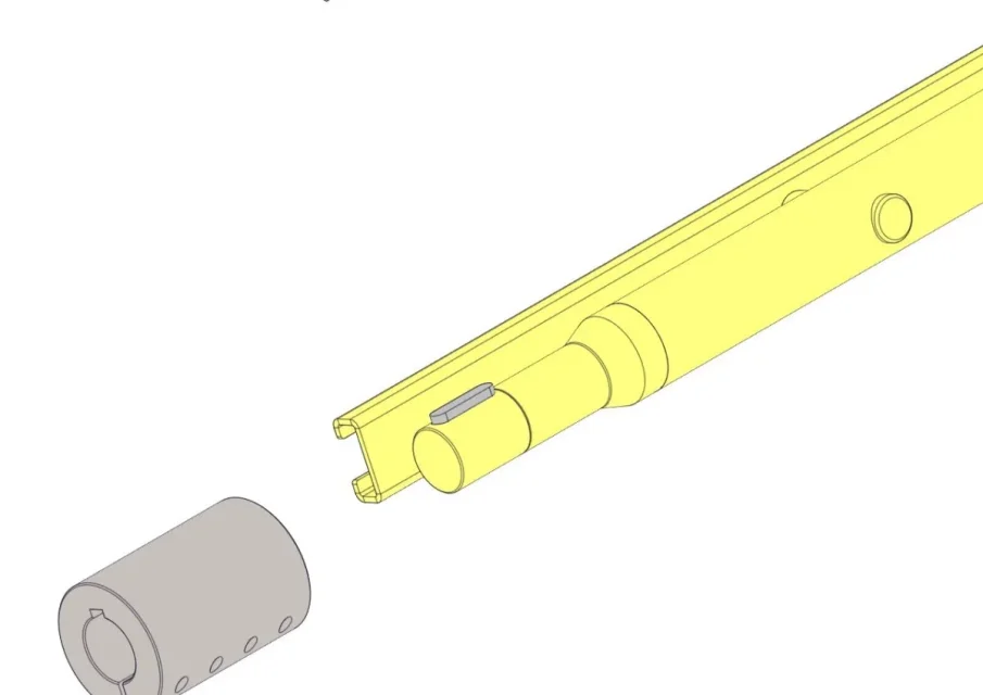

Good afternoon to all.
It's just that I've been using sw composer and I was wondering if there's a command that flattens me the hole axis with the axis of the group of elements.
I'll get you an image of my problem.Dubbio su allineamento.webpI thank everyone who can help me in advance.
you can play with align axes to axes...in turn>allinea...or if they were aligned do copy transformation and will make them do the same shift
ciao @sperx.
Thanks for the answer.
using the first way to mate (allinea axes to axes), how do I create axes for two different bodies?
you do not have to create axes but select the two circles forming the hole...date 2 circumferences recognizes the central axis automatically. ..you have to play a bit, they are intuitive things that aren't written anywhere, wrapped me happen by chance ......
ah ok. at the end of the day load of the pictures where I show the passages.
thanks for the info.
Good morning, everyone. attach images where the components were aligned. In this case, I used "transformation copy" and ,step by step, I show how one of the two components (the tab for precisely) is connected to the appropriate tree seat.
later, I try to make images of other couplings, using "alline--> from line/axis to line/axis".
