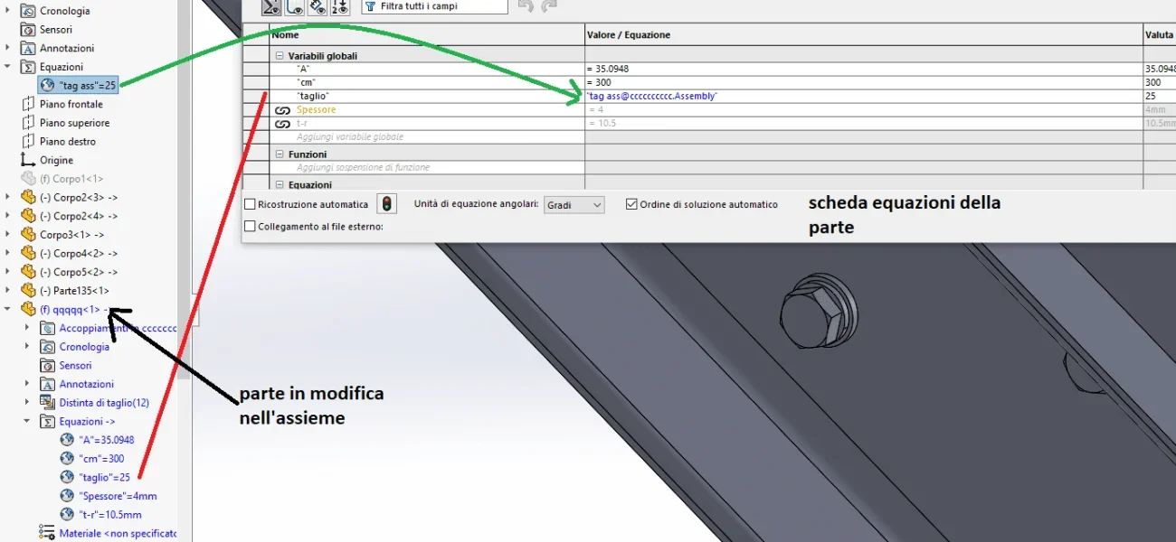

Hello everyone, I am a new solidworks user, I am trying to parameterize a set composed of several parts. I would like to define variables that can be changed at one point... I'll explain... within equations I define the vp1 variable in the p1 part. I would like to define the variable va1=vp1 in the axieme a1. This is because I can have only one point where to make changes (in the general axieme) to variables without entering into all parts or under assemblies and I can also carry out further operations (for example, no repeats of a series...).
I can define variables in each set or part but I can't connect them to each other...
I found these indications I entered into equations, manage equations, inserted into global variables the desired variable, tried to insert the definition in value/equation using the syntax below explained, but the syntax does not work ...
